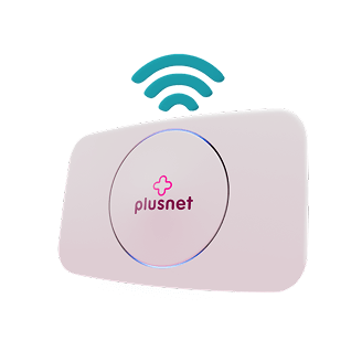

What the hub lights mean
Your hub is connected to your broadband OK
If you can't get online, try switching your device off and on. If it's the first time you've connected your hub, wait a minute or two.
Your hub is working but isn't connected to the Internet
Connect your computer or device to your hub. Open a new web browser window and follow the on-screen steps to get connected. If this doesn't work, use a paper clip to press your hub's factory reset button.
The power is off or the lights have been turned off in the Hub Manager
Check the hub is plugged in, switched on and the lights haven't been turned off in the Hub Manager.
There's a problem somewhere
Use the power button to turn your hub off and on again. If the light doesn't turn blue, use a paper clip to press your hub's factory reset button.
Your hub is starting up
Wait for about three minutes for it to turn blue. If it stays green switch your hub off and on again. If that doesn't work, use a paper clip to press your factory reset button.
Your hub is in Bridge Mode
Your hub has been switched to modem only mode. Full Fibre doesn't support this. You can disable Bridge Mode in the Hub Manager. Or use a paper clip to press your hub's factory reset button.
Your hub is working but the Ethernet cable isn't connected
Check if the Ethernet cable with red ends is plugged in properly. If your ONT's got more than one PORT / LAN port, then try each one. Wait a few minutes each time to see if the light stops flashing.
WPS button -
flashing blue or red
If it's flashing blue it's waiting for you to press the WPS button on your computer or device.
If it's flashing red, it didn’t connect. Give it a couple of minutes and try again.
You’ll also find this information in the printed set up guide that came with your hub.

See our top tips for where, and where not, to put our WiFi hub router.
Do
For the strongest connection, do place our hub:
  • In an open space.
  • Somewhere central in your home.
  • Near your computer or laptop.
Don't
Don’t put our hub:
  • On the floor
  • In the kitchen
  • Near thick walls
  • Next to metal objects
  • Near a window
  • Close to microwaves, baby monitors or cordless phones
  • Near fishtanks or mirrors
We know you’re curious about fishtanks, so if you want more info see our guide where to put our WiFi hub router

For the strongest WiFi connection, it’s best to put our hub:
  • In an open space and somewhere central in your home
  • Away from any thick walls, metal objects or electrical appliances
